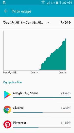

True, but I would like to see a screenshot. Carriers can 'ping' for lack of a better word, a cell phone even with data off. But, 5 gigs doesn't make sense.
Some app is running and not being shut off. Try going to Device Maintenance in settings. Do the Optimize and that will shut off most if not all background running apps lurking around int he shadows. You will never get better than a 90% Excellent report back on a Tab A because the McAfee malware wants to be bought and have enough of an IN with Samsung to preclude you getting 100% until you buy their unnecessary software. In an Android phone (like the S8) when you do the exact same thing, (selecting Optimize) it will go to 100% without trying to hold you hostage to buy McAfee software.

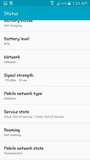

Actually up to 9gb now, here are a couple screenshots of it. Sorry for the late reply, I had lost this link to the thread.
