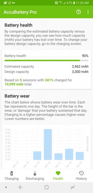

Reading the Note 8 section in Reddit, someone was discussing battery health and posted a screenshot of their battery health % using an app called AccuBattery. Looks similar to how Apple shows battery health in iOS so I downloaded it.
I preordered my Note 8 and got it in October so we’re talking about 15 months old now. I thought it was interesting, not surprised, and seems like a harmless app so I bought the pro version and keep it on the phone to see how battery does next 12 months.
Be interesting to see how other Note 8 users are faring and would be interesting to see how Note 9 users battery are after only a few month. Post your AccuBattey health results here if curious.

2648... 80%... after sixteen months. First discharge and charge today. A far cry from the 95% retention promised by the Samsung Mobile Chief in August 2017 just prior to the release.

Four ... all are consistent with 80%. My 'wear' chart shows approx .92 charging from 40% to 100% on average, on fast charge setting. IF... I can obtain much lower wear results like the OP and not fast charge, that would work for me. However, if I have to do the 40% to 80% charging, I would have to take a serious look at this.
Unless you have the same measurements from the same app when the phone was new, I'm not sure the numbers you are seeing are really definitive as far as any diminished capacity.
I don't think Accubattery is accurate at all.
