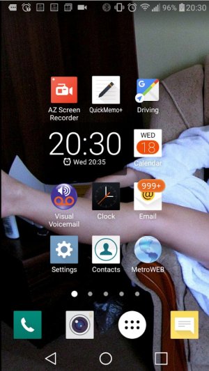

I did some tests on this. Here I show what I did and the results with the stock Clock app on an LG on Marshmallow. I would appreciate if someone can confirm these results on either Marshmallow or whatever.
