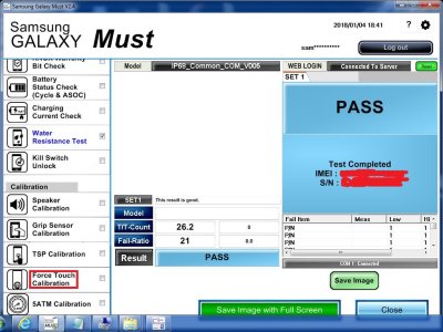

Hello,
Since few weeks I was having problems with pressure sensitive home button on s8. It was accepting light presses and getting activated in the pocket many times. I took it to ASC and they said that they need to calibrate the Force Touch so they flashed stock rom again and calibrated the force touch.. After the calibration.. the home button worked well for days until I had reset my device from recovery. After the reset.. it again started to act weird and get activated by light press. They used their official tool i.e "Samsung Galaxy Must v2.4" tool to calibrate the force touch and test the device for water resistance after screen replacement.
As that official application is not available anywhere on the internet and it requires engineer account for web login.. Just wanted to know if there is an alternative application like that which can calibrate the force touch on s8 ?
