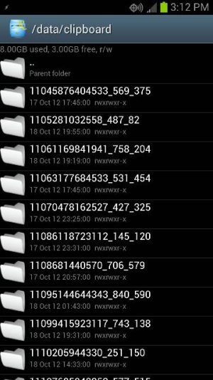

1) Factory Restore your device
2) ROOT your device, install ROOT Explorer, navigate to / > data > clipboard, select ALL and delete all, than go into your Settings > Applications Manager > All, look for TestServices, than remove updates/clear data. Reboot and everything should be fine.

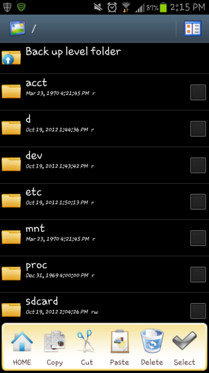

Okay I'm rooted and I went to go find the file and I got this.
Am I in the wrong place where is my data file?
Okay I got one with root access and it shows the data file and it says there's 0 files in it
You're rooted? I can navigate there no problem with Root Explorer.
