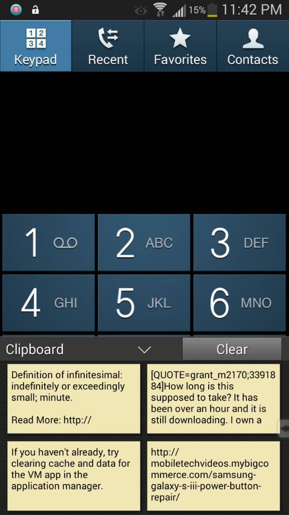

Ever since my phone received the update on 1/10/14, every time I try to copy or paste, the phone restarts. I have a Samsung Galaxy S3 with Verizon Wireless. I do not have Chrome. I have never downloaded any apps. There is only one small text on the clipboard. Also, there is no longer any way to clear the clipboard, like there used to be. Everything had been fine for a year, until this recent update. I tried Samsung's live chat, and they were no help. If anyone has any simple solutions, I'd greatly appreciate it. Also, how can I get Samsung to fix this? It doesn't seem right that they can just come along and reduce the usefulness of a product I already own.
Are you unable to bring up the Clipboard by long-pressing within the Phone dialer app? If it does come up, can you clear it?

Yes, the clipboard comes up, but there is no longer any way to clear it like there used to be.
You're saying that the 'Clear' button is no longer shown?

Yes, that's right, the "Clear" button is no longer shown. When I select the clipboard,*nothing happens for a second, and then the phone restarts. Thank you so much for all your help!
You could try booting into Recovery mode and clearing the system cache.
I looked through the built-in apps list but can't remember where the Clipboard lives; otherwise it might be possible to just clear the cache for that app and correct the problem. Sorry.

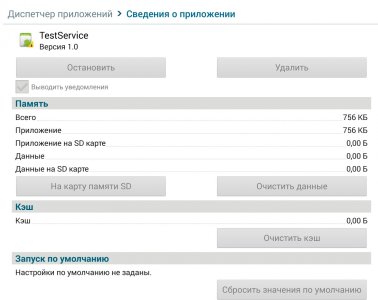

Hey guys.
I was trying to use the 2nd option, but when I founr testservices app on my Galaxy Note 10.1 2014 edition, Its buttons are not active:
**sorry for the russian**
How can I make them active to clean the cash, couse any other option does not work.
thanks.
Hello and welcome to the forums!
How can I make them active to clean the cache, couse any other option does not work.
I'm not so sure that clearing the cache and data will help you - I cleared them both and the Clipboard still showed the expected content. Anyway, if the buttons are not enabled then there's nothing to clear.
Sent from my rooted, debloated, deodexed Sinclair ZX-80 running CM -0.001 using Tapatalk
Hello and welcome to the forums!I'm not so sure that clearing the cache and data will help you - I cleared them both and the Clipboard still showed the expected content. Anyway, if the buttons are not enabled then there's nothing to clear.
