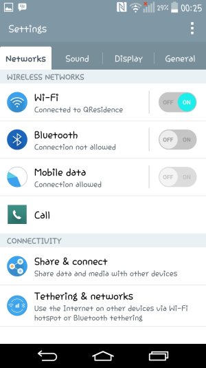

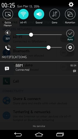

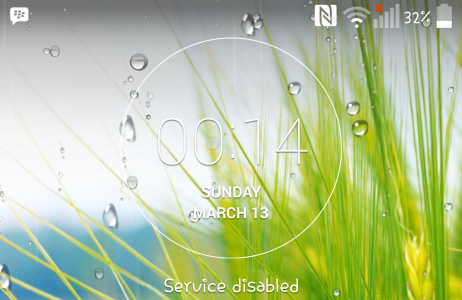

I have googled to solve my problem and found a lots of articles about it but none had the solution I need.
I can't receive SMS or phone call or browsing the internet using my Data. I have checked multiple times and the Flight Mode is not active. As you can see in the attachment, the Data is crossed. I can't activate it.
If I go to Settings - Networks, Mobile Data is grayed out.

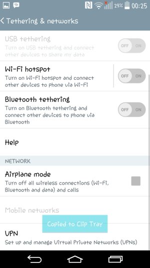

Dig deeper to Tethering & Networks, Mobile Networks is also grayed out.
I just did a Reset Factory an hour ago and the problem persists.

Go to about phone in settings and look for SIM information and see if you have an IMEI number or if that has been erased etc
That's probably why you are unable to access network services as your IMEI is what identifies your SIM to the network provider
Go to Google and search how to backup and restore IMEI G2 and find results from Droid Views.
It is for the G2 but is reported to work with the G3 also
