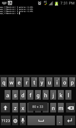

I cant get my msl and im sure ive been doing this right
Upgrading to Jellybean seems to prevent that app from getting the MSL. Best bet is to call Sprint and tell them that none of your friends receive your picture mails.

Type "su" (no quotes),
hit enter (should see # instead of $ at this point),
then type "getprop ril.MSL" (again no quotes).
after I opened connectbot and entered getprop irl.MSL I got a message saying "no host connected." ani ideas or advice?
Get Alogcat from the play store and install it, then go to phone screen after installing and enter data mode (##3282#) then hit edit and enter anything into the MSL field, then quickly switch to the Alogcat app and pause it, filter the log for "MSL" (no quotes) and in the log each wrong attempt at the MSL will be logged with the correct MSL shown in the parenthesis.

This (Alogcat) helped me get my msl successfully... I actually typed msl and entered search... Logs containing msl displayed....
