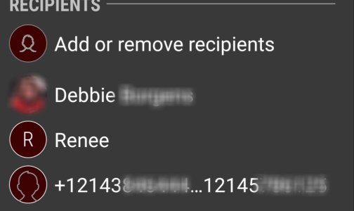

I am having lunch with some of the folks in the group text where I first discovered this issue. I will ask to look at their fruit phones and see what it shows in their recipient list for our group text message. Here is a screen grab of the recipient list from one of the group texts.

So I had lunch with three of the folks who are in a group text that is experiencing this issue. I looked at their fruit phones and all three of their phones displayed the group message information as it should be. No crazy number.
However, we did a bit of experimenting while all together. It seems that the issue is connected to just one of the contacts in the group message. This is what we did hoping to resolve the issue along with the weirdness that happened.

I received the text but it appended itself to one of the group texts of which she is part of but it was not sent to or from the group text. And not only that but it came through with the crazy number. Remember, I had deleted her from my contact list. When I look at the details of just the individual text message (press and hold the message and select Details), it displays her correct number, not the crazy number.
I added the crazy number as a contact using Jane Bad. But somewhere along the line, my phone has connected Jane and the crazy number.
My theory...somewhere along the way, her number has become corrupted on my phone. I have no clue how it happened or how to fix it...
