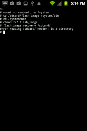

I tried doing what you said and i'm copying and pasting it and getting an error

Hello, just need to rename the recovery file before transferring it to SD card, or change to the correct file name on that command line.
