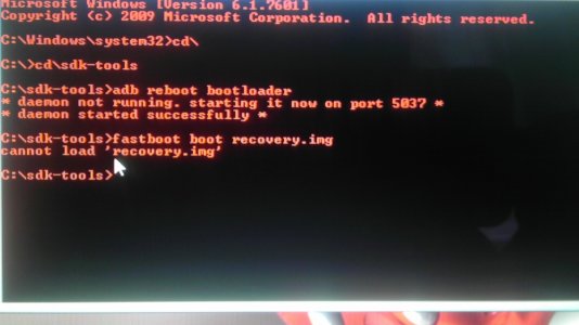

i need some help I have been following the step to the T but I always get stuck trying to fastboot recovery.
C:\sdk-tools>adb reboot bootloader
* daemon not running. starting it now on port 5037 *
* daemon started successfully *
C:\sdk-tools>fastboot boot recovery.img
cannot load 'recovery.img'
C:\sdk-tools>
I have the recovery inside my sdk-tools folder
im not seeing what im doing wrong I have a htc evo v 4g hboot 1.58.0000
I need help please anyone

Are you unlocked?
Make sure its named 'recovery.IMG'
Also try and just type this
Fastboot flash recovery recovery.img
Sent from my Evo 3D CDMA using AC Forums mobile app
Then from boot loader just select recovery
