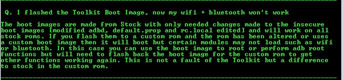

ok so I found something in the toolkit that may help, but I need help understanding.
I don't think this would apply to you. Since you weren't already rooted you wouldn't have a custom ROM. Did you flash the Toolkit Boot Image?
I do not believe so. All i have done is the toolkit to root and got rid of a few crap bloatware apps.
