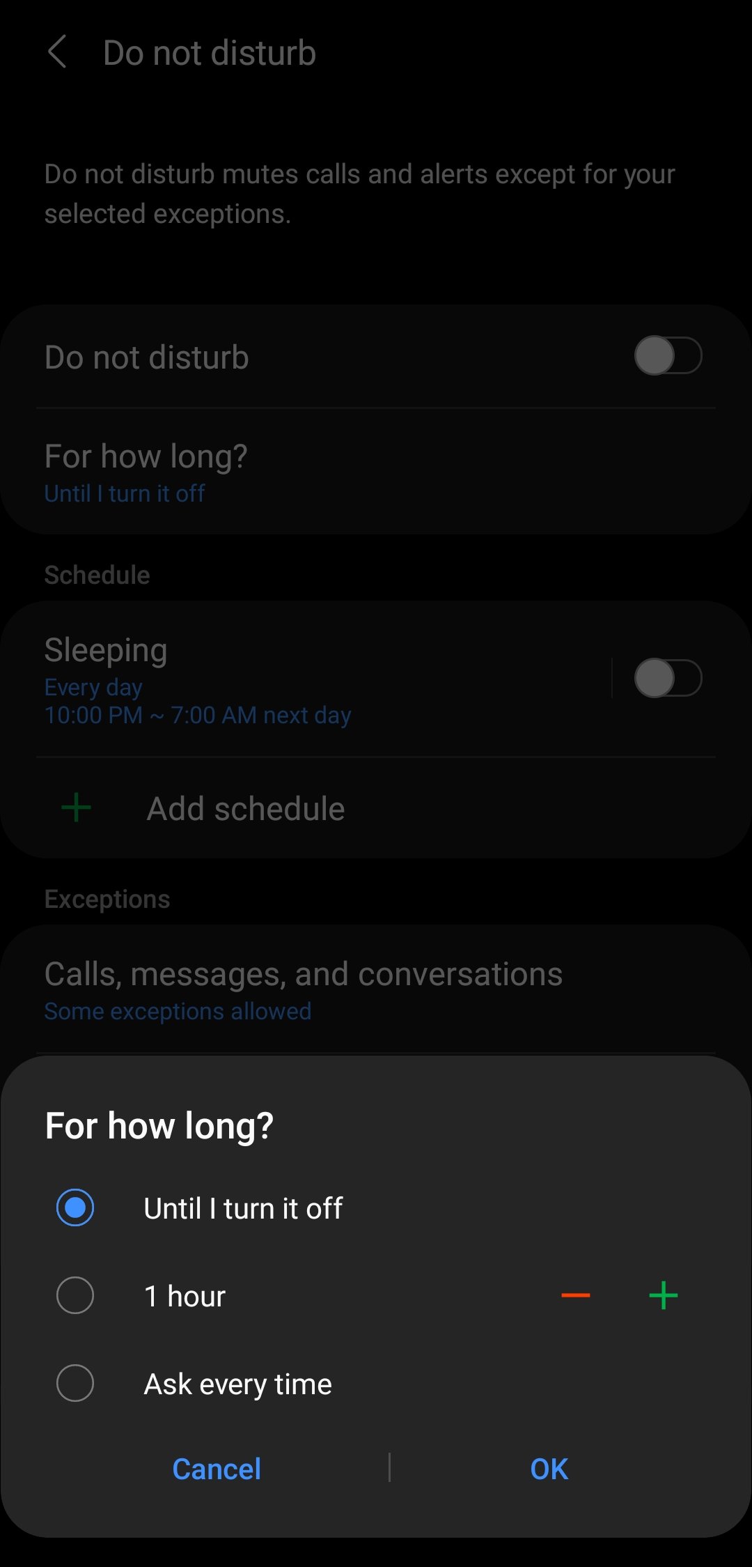

Maybe a workaround while you dig deeper in Tasker or Bixby could be using Do Not Disturb. You can set it to 'Ask every time' you turn it on. This way when you enable it from the quick settings panel you can select the duration.

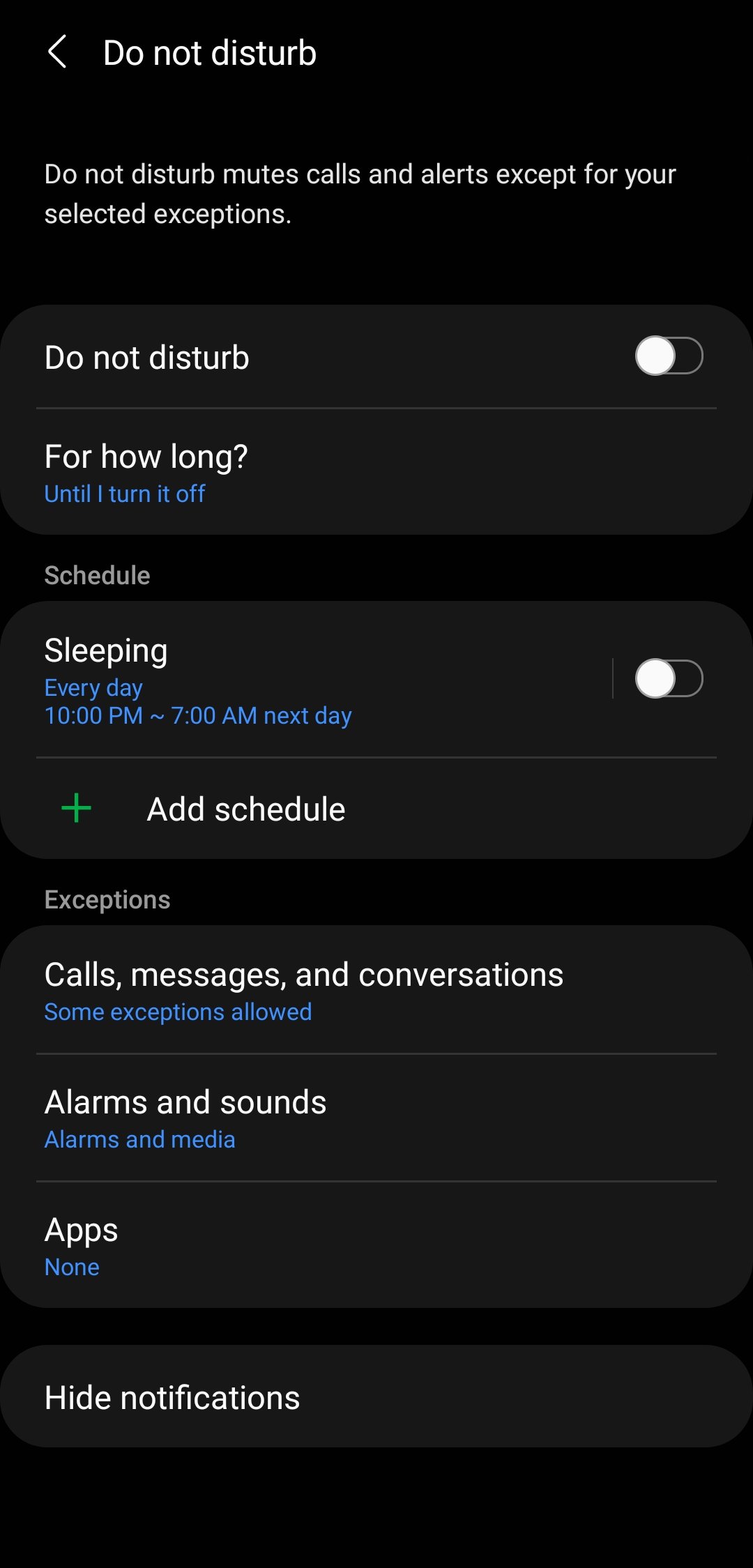

He has different phone so when you pull your notification panel down and see the toggle for DND long press it and it will take u to it's settings
It would look similar to this on my Note 20U
