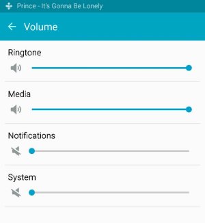

This works flawlessly for me - just got to Settings/Sounds and Notifications/Volume. Then slide all sounds you do not want to hear down to Silent. Done!
(In the screenshot you'll see my ringer on because I personally DO want my music interrupted by phone calls only since I'm relaxing but waiting on a call. Set all yours to Silent EXCEPT MEDIA - KEEP THAT TURNED UP to the music volume you want)
This did the trick for me. I also want to keep my ringer turned up because I listen to podcasts at work and if my boss calls I want to hear that come through, but I don't need my audio interrupted every time a get a Hangouts or text message.
