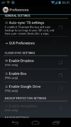

Menu-pref-app mode-auto direct my says auto sync - same thing?
The app processing mode is near the bottom. Scroll down more. I think it may be only available in the purchased version, however. I'd take a screen shot, but my volume rocker seems to be acting up right now.
you are correct pro version only...
