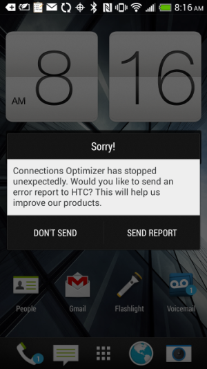

And speaking more to the issue that I've been experiencing, it's the connections optimizer that will crash. To get my phone operating on the correct network, I'll need to usually do a reboot.

Same here. I can't send the crash reports, because I need to reset. What's worse, it happens while my phone is in my pocket and I don't realize my phone is not connected.
I never use the connection optimizer and don't have any issues with re connecting to known WIFI networks or connecting to 4G when in range. Other than a little slowness switching into roaming (which seems to be getting a little better..), this update is working fine.
Happens in my pocket, out of my pocket, everywhere. Phone does overheat quite a bit, especially while navigating in an unfamiliar area.
