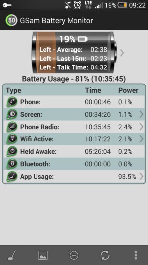

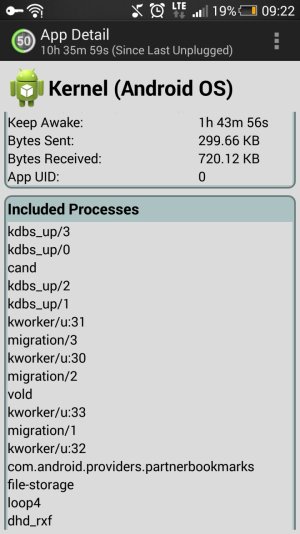

Hi!
I have a canadian carrier version of the HTC One (Telus) and since I've updated my phone with the 4.3 version on September 30th, the battery performance is getting worse and worse. For example, after 10 hours unplugged but almost not used (2-3 text messages and 5-6 webpages), the battery is down at 20%! Before, the update, it was around 75%-80%. I haven't installed new app since the update, except GSam battery monitor to find out the problem. In the stats, it tells me that "Kernel (Android OS") is responsible for more than 70% of my battery usage. I really think this is not normal at all... Do some people have experienced the same problem?
Thank you very much for you help!

First off, after each major OS update, you may experience battery draining faster than usual.
You can start by performing a cache wipe and see what happens from there.
Wipe cache partition to clear system memory: HT... | T-Mobile Support
This procedure will work with any HTC One.
If after this you still notice battery issues, last resort would be to perform a factory reset.

So I don't know if this is of use to any of you but I had the same problem and none of the above fixes worked. I received a message from another reader on the HTC Canada website, and it did the trick.
Go to wifi settings and choose advanced and go to the "keep wifi on during sleep" and select never. This has fixed my battery problem and I can now get through a day again as I was able before. In fact, my phone has been on from 7:30 Am to 5:00 PM and is still at 74%. Last week it would have been at 40% or lower.
