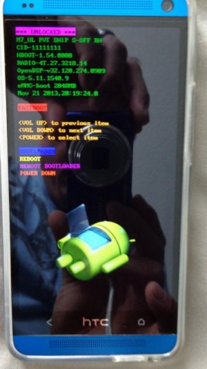

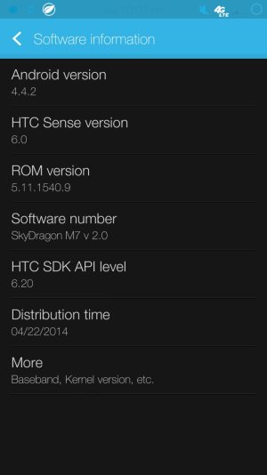

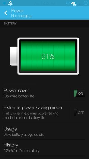

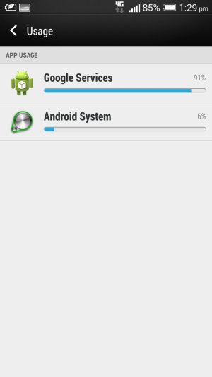

I had a drain issue when I installed a firmware from an ota kitkit update. I think the latest firmware for Europe is 5.11.401.10, I believe. Recently, I installed 5.11.1540.9, US dev. Edition firmware and the issue went away. I think one of the European OTA's had an issue with Google Services reaming the battery life, then they released, yet another update.
Another thing that helped me was installing the latest firmware for my region and installing a rom that was based on that specific firmware. I hope this helps. Also, I charged my phone last night, when I woke up it was still 100%. With the new update, my battery drains on the average .5-1% every hour. So in 10 or 11 hrs, I love 1-2%, but that's just standby, without really doing anything. One other thing you could try is RomCleaner 2.2, it comes with a .txt file that you can open with notepad++ to keep or remove unwanted apps. This is assuming you are using a custom recovery, though.
You could also try turning off background data when your aren't using data connection. Its in settings>mobile data>data setting>limit background data. Another thing you COULD try is calibrating the battery, by powering off the phone, holding both volumes+power for 2 minutes and releasing them all after that. The phone should boot normally after.
I also use a custom kernel, and overclock the gpu/ cpu(1836Ghz/410Mhz) and undervolt to 762.5@384Mhz, without loss of performance or excessive battery drain. See attachments.

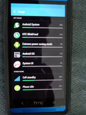

39% being used by Messages. I never keep messages after I am done texting with someone. There are 0 pictures, etc in any of them now. I only have 3 texts in my Message app.
Cell Standby shows 24% battery usage
Phone idle shows 20% battery usage
Not sure what these 2 are supposed to show normally.
5 other apps show a total between them of 19% of battery usage.
