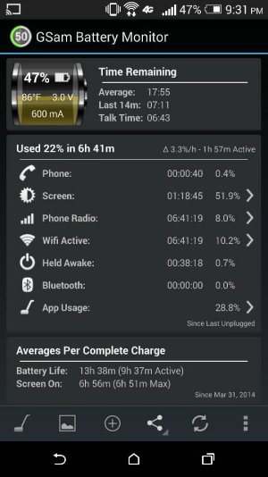

I would have to see your screenshot of 7 hour battery time to see the M8 getting that without charging sometime in between. The only reason is because in your screenshot your phone radio was only on for 6 hours and 41 minutes. So in under 7 hours (with 1 hour and 18 minutes of screen time) you are already at 47 % battery. So the phone being on for 7 hours and the screen as well for those 7 hours without ever being plugged in doesn't really add up ....
If you look at the top section where it lists everything and gives you the time all those were used, it says at the bottom right corner in small print since last unplugged. That's the reference point at which it starts to measure and record.
I'm referring to the bottom section where it says averages per complete charge. According to that, I get 7hr max screen on time with about 13hr battery life.

Again the bottom could be 7 hours of screen on time and you easily could have charged it some during that as most stats don't reset until 90 percent or higher on most phones.
If it's easy to do 7 hours why not get a screenshot of actual recorded usage? I am just hard pressed to see 7 hours average screen time on a battery smaller than my Note 3 when that is not a common screen time for most phones in the market without some sort of charge in the middle or something.

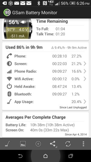

I cant figure out whats wrong with my settings but take a look at this and tell me what you think. My screen brightness is set half way and auto brightness is checked. Im barely using this thing. My carrier is Verizon. under app usage kernel is 25%, android system is 1.3% and everything else under 1%
under screen it says discharge while on is 3% and while off is 45%
Im barely using this and it is not making me happy.
Correct me if im wrong but it says I used the phone for 28:10 and used 27% of batt.. I unplugged at about 8 am and by about 5:00 its alerting me at 14% I love the phone but something is out of whack. Completely turned off wifi today to see if it helped, but no it didnt..
I switched from sprint with the M7 because of terrible reception but loved the phone...
Anyone have any ideas?

Look at your Held Awake time...something is keeping your phone awake and not allowing it to deep sleep when you're not using it. Check your apps.
Does the Held Awake not ensure that the data connection is kept on and therefore allow you to receive emails, keep streaming apps playing music etc?
From the Gsam user guide
Held Awake: This is the amount of time that the phone appears to be sleeping (screen is off), but some application is preventing the phone from going into a deep sleep. This is one of the chief indicators of unneeded battery drain. This is similar to the 'Idle' value in the built-in battery usage, however we don't include the screen on time to help with clarity.
Battery Saving Tip: Apps should not wake your phone up out of a deep sleep. If the Held Awake time seems high to you, go into the App Sucker task, and sort by 'Time Held Awake', and 'Num Times Waking Device'. This can help you identify a misbehaving app/I]
I don't think data connection to receive emails would be reflected here, but if you were streaming music during that time then, yes it would be awake by virtue of the running app.

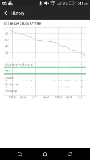

I have been getting fantastic battery life. This was a little bit slower than normal day, but the fact that I can get almost two days out of it on a slow day means I'm not worried at all about a heavy day of use.

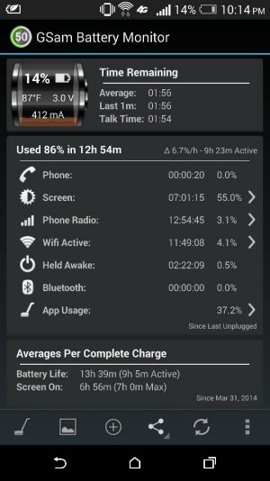

Here's your screenshot buddy. 7hrs screen on time. Very good battery life indeed
