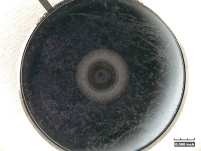

I purchased the htc one M8 in early April and as of the middle of May the quality of photos has degraded to a point that photos are bad. I compared it to a brand new one at the store and using the same settings, there is a big difference. The lens or lens cover has many pit marks or fine scratches that has interfered with the quality of photos. I am including a photo taken at a quality control lab for Lens_001.jpga review.
also did some chemical analysis in consultation with several material engineers that I work with and it does look like it is a coating that is the problem.
