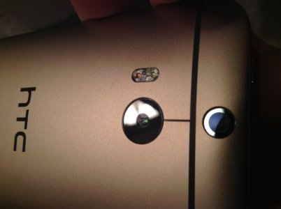

I just took the coating off both my rear lenses, 10min job
My M8 posted this
