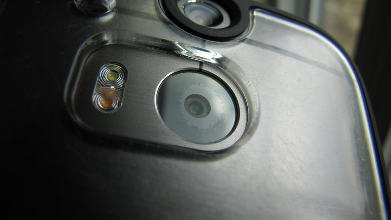

I had this same hazy camera lens cover issue which was making pics look hazy. Grabbed a bottle of Meguirs Clear Plastic Cleaner I had sitting around and a microfiber cloth and in two minutes all was good. Finished it up the Clear Plastic Polish and it looks like new.

I'm glad I found this, done the toothpaste and a little alcohol and my pics are clear again. I don't think this coating was meant to be there.

I agree wholeheartedly.. My new replacement camera lens just started doing the same thing all over again.. Obviously sending it in a 2nd time is not going to correct it. So.... 1 q-tip, a dab of Colgate toothpaste, about 3 minutes of rubbing a little hard in a circular motion, wiping it off with a slightly wet micro cloth and I am back to taking good pictures again.. I will get around to cleaning the rest of the lens for aesthetic purposes one day. :)
Results attached..

Guys so I had the same minor little scratches on the main back camera, the top camera and the front camera.
I followed people and used the toothpaste method and It WORKS like a CHARM! brought the camera back to new!
You just have to use a qtip and buff it with the toothpaste for a few minutes in different directions. Then clean it off with rubbing alcohol and then buff it with a cloth. Used it on all 3 cameras and its wonderful!
No need to send it back to HTC.

I watched the haze slowly build up on my main lense and decided to take action today when a picture I took outside came out looking pretty rough. I used some Meguiars PlastX (plastic cleaner & polisher) that I had laying around. Tiny drop on a microfiber wipe and it came off in seconds. All good!

My Fix worked today and took less than 5 mins 100% guaranteed .
2 cotton buds, autoglym car polish, work in the polish to remove the very poor lens coating with a cotton bud, you will instantly see the improvement, clean with fresh bud to inspect and re apply as and when necessary.

Haven't noticed any difference whatsoever. If anything it's slightly better. UV filters on digital cameras have traditionally been used as transparent lens caps rather than anything beneficial to the image. I can assure you that taking off the coating will do absolutely nothing negative.

Well I'll turn it around and say you generally shouldn't trust people on the phone who are essentially reading you a script. It's surprising that they haven't heard of this, but they really don't need to.
I can assure you that the cleaning methods work brilliantly with no adverse effects. I'll even upload a video showing the process to YouTube for you if you'd like. I have a bit more of the coating around the edges of the lens that aren't affecting anything but that I was planning on getting off for aesthetics. If you do the toothpaste method just make sure it's the plain white kind, none of those crystals or whitening strips. But yeah, it's not going to hurt your phone. If you exchange it for another it's just going to happen again to that one in a couple months.
