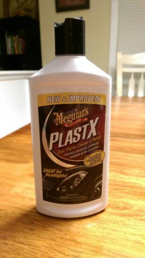

I watched the haze slowly build up on my main lense and decided to take action today when a picture I took outside came out looking pretty rough. I used some Meguiars PlastX (plastic cleaner & polisher) that I had laying around. Tiny drop on a microfiber wipe and it came off in seconds. All good!
I used the Meguiars PlastX (Thanks btbam08) a couple of nights ago and now my phone is back to taking great pics again! Finished it off with screen cleaner and microfiber cloth. Thanks everyone for the suggestions!

I tried 99.9% pure alcohol and a cotton swab for 20 minutes, and it didn't work for me. Panic set in, and then I went to Wal-Mart and spent $7 on Meguiar's PlastX. Used that, combined with a microfiber cloth. Worked perfectly. Highly recommended. Only the edges around the perimeter of the lens show signs of the coating. I might get ambitious later and finish it off, but for now I am happy! Great pictures again.
