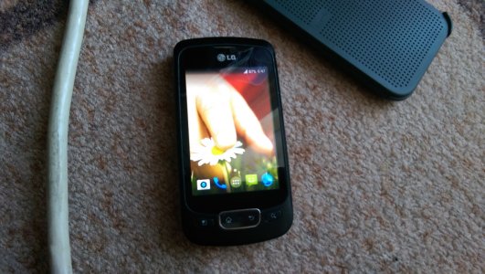

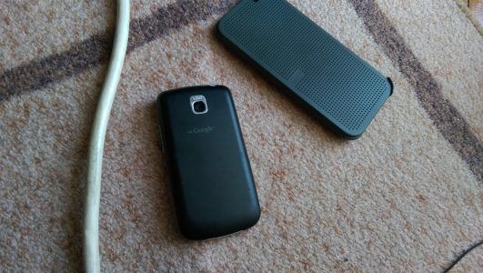

Thanks for the fast help.I want to ask another thing.I am not sure that my lens are scratched,so i will ask for ur opinion by uploading some pics.Because on my vacation my photos looked like **** (very blurry as u will see) idk if it is because my hands are shaking or there were fingerprints on my camera.I am confused because there is circular thing on my camera and it looks very strange.
The dogs pictures are from the vacation and the others are after i've wiped the camera little.(i am still not sure if the photos after the wipe are sharp enough)
