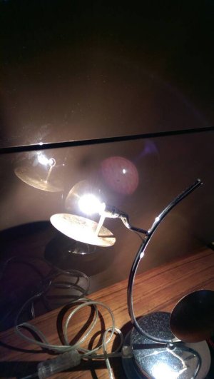

Re: HTC One (M8): Camera lens cover issue
I think it is wrong to advise you to "polish" the camera lens, the coating that people recommend is to remove the anti-glare filter (or UV) taking it the photos are sharper because obviously it regains transparency but in the case of counter lights or daytime running lights they have reflections, halos of weird colors etc..
HTC must provide to fix this defect that at this point seems to be linked to the bad heat dissipation of the lens associated with a film that Climb down with the heat detaches.
after removal of the anti-reflection problems are these

Could you post additional pictures of this happening? Lens flares are normal on any camera, but that one does look pretty extreme. I'm not having it happen on mine though.
