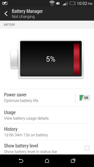

I did read it and factory reset twice. My android system is using alot of my battery
Is this normal?
