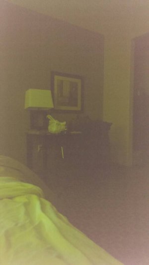

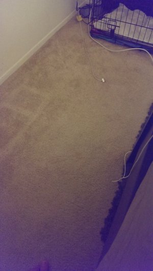

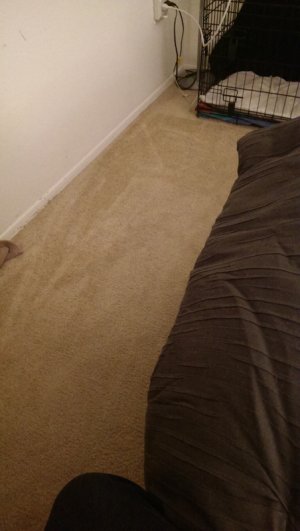

Hi everyone!
I'm back with the update. So before I sent my device back to HTC, here is the photo I showed everyone.
I sent my device back last week and they received it on wednesday. Exactly 1 week I received it back in my hands. It arrived in a nice box.
I immediately tested the camera in the same lighting conditions and here are the results:
FIXED!!

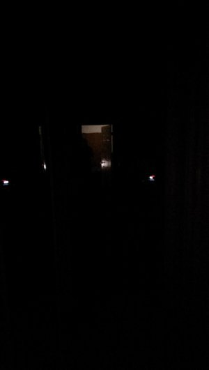

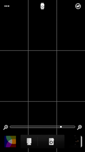

Here's another photo i took in a pitch black room, and also the screenshot of the phone when laying on a blanket (no light coming through at all)
So it's safe to assume that this is definitely a HARDWARE issue. Maybe a certain production date - production date had bad cameras. The production date of mine was april 2013, in taiwan.

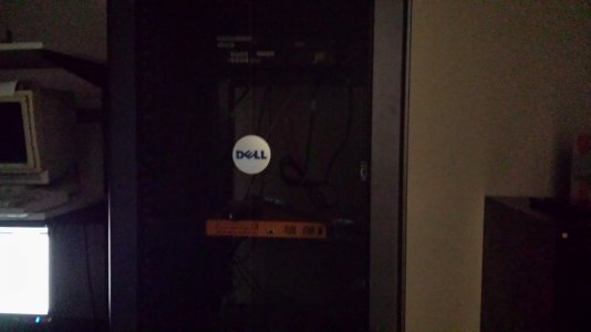

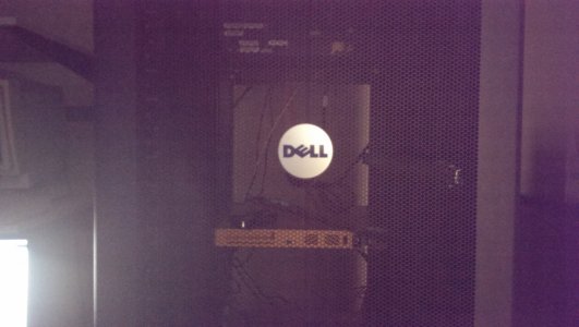

I will have to agree that something is causing the issue. To me it looks like light trying to come through. I have attached to photos of the same thing. One is with my HTC One and the other is with a SG4. You can clearly see the purple in the HTC. The SG4 it is dark just like the room is. Raysurrx7 how did you go about returning for repair?
HTC
SG4

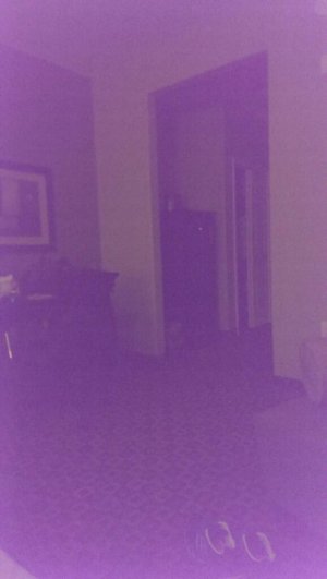

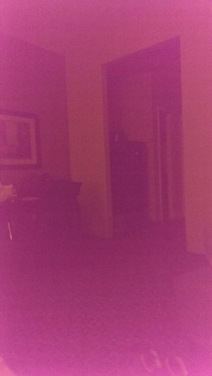

I thought I didn't have this problem, but these low light shots in my hotel room show major problems.
Sent from my HTC One using AC Forums mobile app
