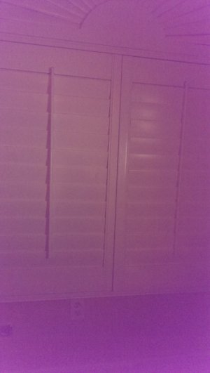

My camera has to be replaced, right? it's just me of that every device been produced has this problem?
the 2 first shots went ok because they had enough light
after that you can see the problem... Some of them with ISO 100 that really didn't changed.. also when there's no enough light the image is distorted, you can understand nothing.no focus, can't take pictues at night...

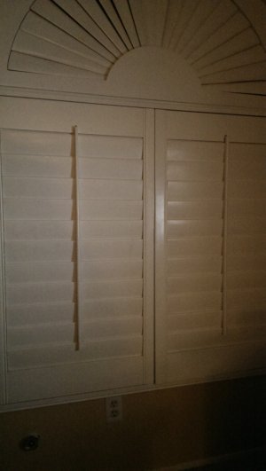

Best way to check this is to turn on the camera, and then set it down on a bed, or something that covers the lens completely. If it's black, you should be good. If it's purple, you have a problem. This is what mine looks like now :
Before my repair, it had A LOT of purple in it.

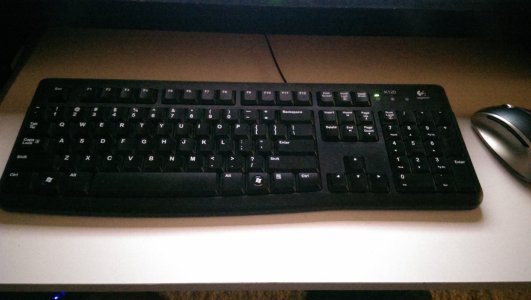

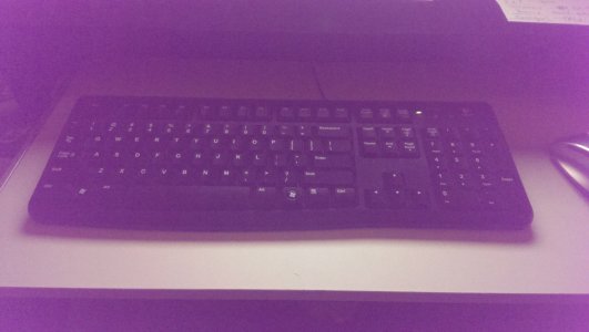

I took some before pics to verify so I can do the same pics again when I got the phone back. All I have to say is WOW! See below for the pics. Same lighting conditions with no flash and all camera settings on Auto.

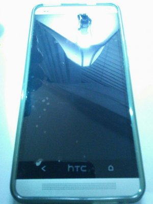

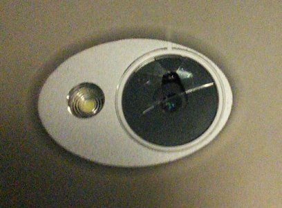

I got my phone back 6 days ago, working perfectly. Then I took it to Best Buy to get an Invisible Shield installed. After having them reinstall 3 times due to poor fit, then broke my lens cover:
Check out the "professional" installation (after three tries, mind you) :
My big mistake was leaving the store without checking the entire device over. They only offered to give me 50% of the deductible to get a replacement through insurance. 😢
