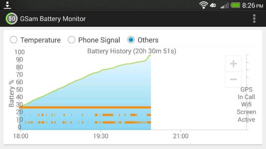

My sprint HTC one did the same thing all the time I literally could not let it reach 10% or it would be dead within two minutes even if the screen was off. I don't think it's a bug probably just how HTC engineered the phone. And as far as the 92% thing it could be due to the phone charging to full then discharging and recharging while plugged in but the phone will display 100%. Don't know if it's a bug or not though
I'm trying to understand this bug, as you can see my charge chart is pretty normal until 90% where it shoots up. This must mean that the software is just saying the phone is charged when in reality its not, so taking it off the charger right after it reaches 100 would cause it to quickly drop back to the low 90s.. If the chart were right it would be a nice slow trickle charge to 100. So in other words the phone is lying for whatever reason.
Sent from my HTC One using AC Forums mobile app
