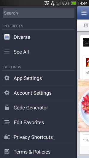

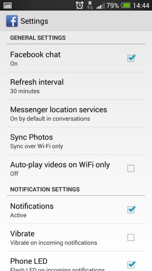

Cant find it :l
Press the menu button at the top left corner. Then scroll to the bottom, find app settings and uncheck vibrations.
