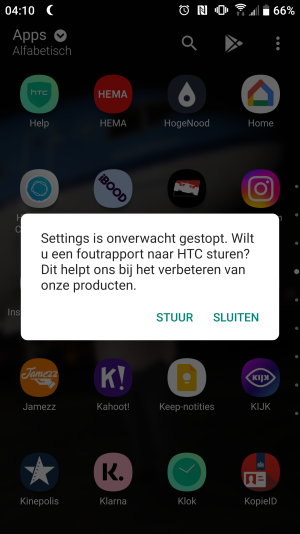

Every time I try to open the settings app/menu on my HTC U11 it generates a fail message.
Reset to factory settings did not solve the problem.
Anybody knows what is going on?
I've got this issue too on same phone. tried the safe mode and settings button on notification panel and issue is still there.

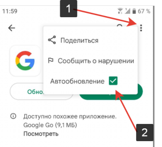

As for me solution is to disable AutoUpdate in Play Market settings. Sadly all other updates need to trigger manually, but at least it's controlled now what I'll update. Sadly that there is no option to opt-out some programs from AutoUpdate.
I have just discovered that autoupdate can be disabled for the individual application.
