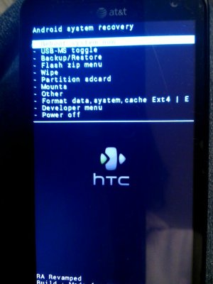

Here is what the recovery will look like:
Sent from my HTC Vivid WCX using Android Central Forums
