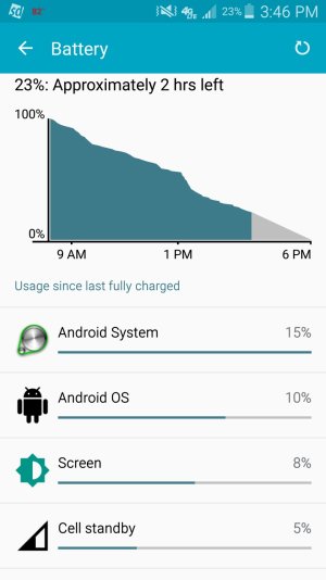

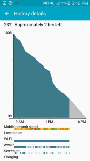

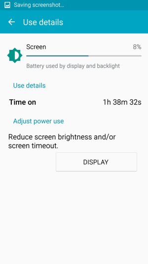

So I have had my Note 4 for nearly 6 months now and the battery has never been what I expected. On a really good day I would get 4 hours of battery life, but usually it is worse, and yes, I have factory reset it. Yesterday for example was absolutely awful. I watched one youtube video at 9 in the morning (20 mins) and left the house for work with 85% battery at 10 in the morning. I worked till about 4 and when I pulled out my phone it was on 20% battery. Keep in mind that the only time i pulled out my phone was to check the time. I have attached all the screenshots of my phones battery info. The phone had 1 and a half hours of screen on time, much of which i attribute to my phone repeatedly turning on in my pocket. Also the strangest thing about this whole instance was i turned my wifi off, yet my phone says it was on the entire time, and I am sure i turned my wifi off. Is this a software problem, or is this a problem with my phone or my battery?

Your mobile signal is horrible, which will murder your battery!! But... it looks like your Wi-Fi was on 100% of the time. Is this the case??
I must agree that the Note 4 has been sub par but from what I've read the s6 battery is worse. From the screen shots you've posted it definitely looks like you have a software bug. This battery life reminds me of the note 3s after the 4.4.2 update, no matter what you did the battery was just terrible.
On my old network (still on note 4) I had terrible signal and it caused battery drain but nowhere near as bad as what you are experiencing so I don't think that is the main problem. Do you have sync turned on? I'd try another factory reset and if that doesn't help try another battery. If that doesn't help either you may need to contact samsung or your network provider

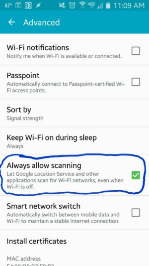

I have that wifi stuck on thing too. It just started happening about 2 weeks ago. I KNOW the wifi radio is switched off and so is scanning and so is the Optimization box. I'm still trying to figure it out.
In Wi-Fi Advanced settings, turn off "Always allow scanning". If this is checked, your Wi-Fi never truly goes off.
I agree with previous comment that your cell signal is not great at all and poor cell signal is one of the primary battery drain areas. Followed by weak Wi-Fi signal.
Thanks for this tid bit goin_nil. Again I learned something new or must have somehow missed this. But thank you for the reminder! 😎

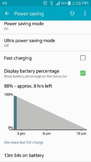

Is it normal ??? My note 4 darins 1% in 5 mins . My all bloatware apps are disabled and phone is on power saving mode . I bought this phone on 28 june .
Yestarday i was charging note 4 . I touch the phone its like burining hot i take off the battery and cool down . Now again i charged and not happen again overheating .
Sorry for my bad english .

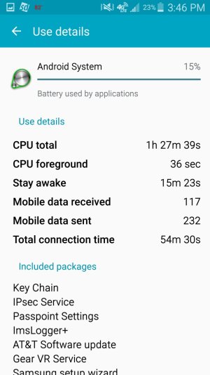

For me at least, it seems that "Android System" and "Cell Standby" are using significantly more battery than I remember before the at&t update to 5.0.1, and my battery doesn't seem to last as long before having to do a battery swap or recharge. It seems they used to only account for 1 or 2% of battery consumption, but now are usually between 5 and 8 or 9%.
Factory resets and cache wipes have not seemed to help, either.
Coincidence?
