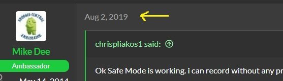

Welcome to Android Central forums. Jumping in right away, that's good to see. It gets tricky around here sometimes, if you look above the comments you can find the date of the post. This thread is from 2019. Hahaha. No, worries. You should hop in the intro thread and tell us about yourself. What device you have, which you want, how long have you been into Android. You can use this link.
See you around.
