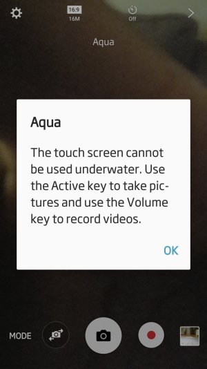

I'm on the S6 Active and the warranty language is the same for the S6, S6 Edge. The Samsung warranty is voided by water damage. OK, I get that this device, like the S7 and S7 Edge is water RESISTANT, but why on Earth would they encourage something like this? It's like ,"Oh cool, my camera can take underwater shots and I can use the physical buttons to do so." "But wait, the phone isn't water-proof so how is this supposed to work?"

I've had my S7E for two weeks, and the one of the selling points to me was the water resistance feature. this does not mean I'm going to take/make phone calls while I'm in the shower. this does not mean I'm going to pretend to be lil wayne and pour ANYTHING on my phone on purpose. this feature is for those accidental drops into a kitchen sink of dish water, or getting caught out in a serious rain shower. even though there are a metric TON of youtube videos out there showing phones in water for hours, WHY would anyone want to take a chance on the slight chance of ruining your device? I work two jobs, am not made of money, and won't be doing my best lil wayne impression with this device, EVER.
Ha ha I would totally take this phone to a water park for some awesome videos lol, if it didn't have a glass back...My Gear S NEVER left my wrist from launch till recently, except to charge.. Showers, pools, hot tubs, water slides, took it like a champ. Never a problem ( I just had to disable the wrist gesture to avoid the water on screen calling people lol). Now, I have the Gear S2 Classic (3G version of course) and do the same thing, after I replaced the leather with a silicone strap... I totally answer calls in the shower from my watch.
