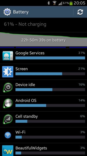

Re: I hate my new Galaxy s4.. Battery life drains 1% every MINUTE of use.
How the heck is your screen using only 21%. Mine is 1/3 of the way up and I'm using 50-60%?? I never see it less than this.
Maps and the Nike running up are using 15 and 10% respectively. I tried closing task via multi-tasking, stopping them, fore stopping, etc. but they won't go away.
