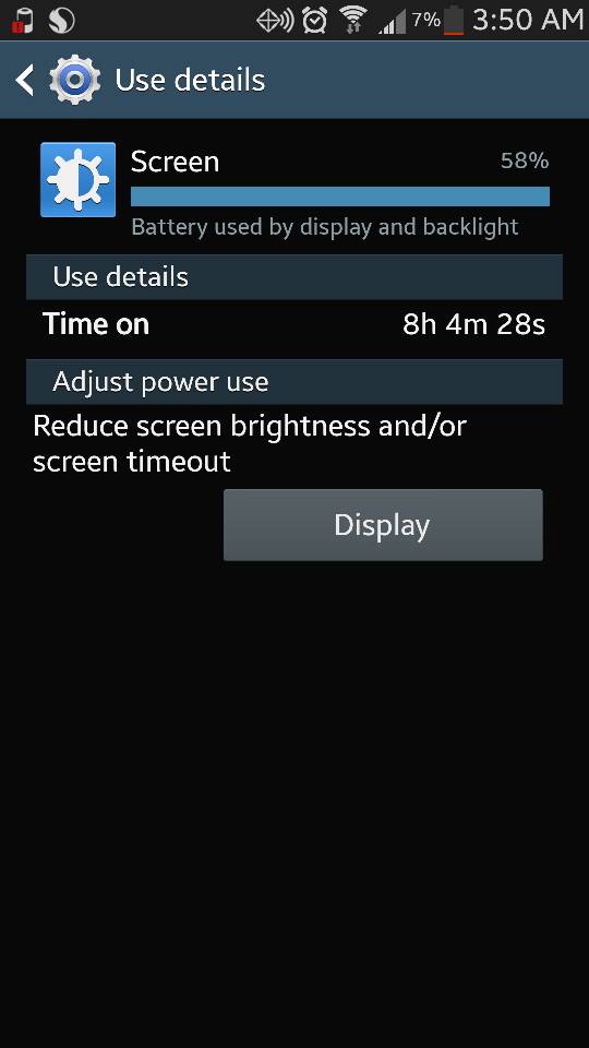

Here is screenshots I took of my battery. I'm currently using Anker 5200mah battery for my s4. Loving the battery, only issue is there isn't really any case that I can use with the extended battery.
I do not use any of the features like smart scroll, smart pause, and air view. I have snapdragon battery guru on that automatically turns my WiFi on and off. I consider myself a decently heavy user for games, music, internet, and social apps.
Edit: just found out seidio active extended battery case works with this anker extended battery. I will most likely order one. Had 2 other seidio cases in the past and both were great. Looking forward to finally putting a compatible case on this baby.

Re: I hate my new Galaxy s4.. Battery life drains 1% every MINUTE of use.

Holy **** lol

Not bad for a gamer.
