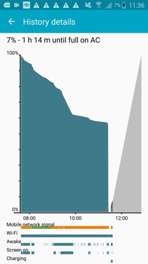

I'm having a similar problem to Shahbaz. It started about a week ago. Suddenly my battery will only last about 6 hours with very minimal use. I never had this kind of problem before and I have not done anything different to my phone. I upgraded it to the latest Verizon android version the day after it came out but that was several months ago. I have tried wiping the partition cache and have noticed not difference in the battery drain. Mine also did as Tivoboy's did this weekend.... Had about 16% battery and tried to check something real quick and boom, shutoff. Any suggestions?

I'm having that same issue where the phone suddenly dies once the battery hits a little below 15%. I came to this forum hoping to find an answer.
I had the same problems with mine dying after it reached about 10%, I read that it is the battery. After purchasing a new battery I no longer have an issue (and of course I am getting more battery life out of my phone!).

I had issues with my battery. It would drain fast and at ~30% it dies. Got a replacement phone (due to another issue) and was still the same. Got a new battery and it lasts longer and doesn't die at ~30%.
My Note 4 battery just died with nore than 50% remaining. It's never happened before. It was happily downloading some updates from Google Play. Suddenly it turned off. When I turned it back on, the battery was at 0%. I don't understand how a battery could possibly discharge like that. It would make more sense that the software measuring the remaining battery was faulty but it had only been on half a day.

Doubtful. Sounds like your battery may need replacement. You should try to see if this is consistent and if so, replace the battery.
