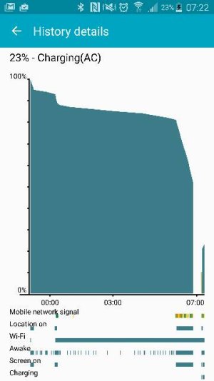

Just a guess, but the Note 4 might have been in the process of downloading an update when you shut it off. Try removing the battery (if you can do that on a Note4) and then reboot normally. Again, just a guess.
