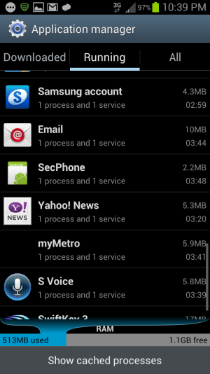

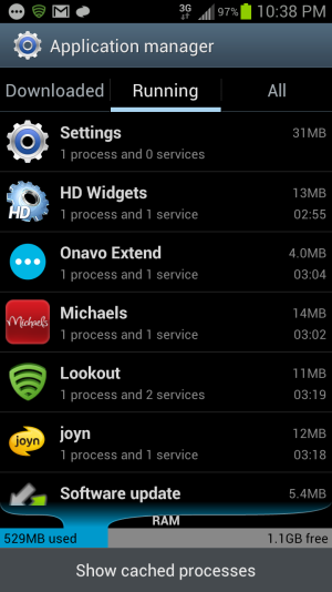

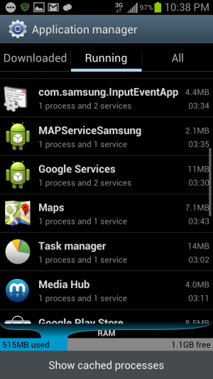

That's what I was trying to ask originally. All those apps running in the background.......how do I stop them from running????
Missed this...one thing you can do..click and hold the home key, it will pull up the task manager. There will be small windows of many things and at the bottom, you have (from left to right) a pie looking symbol, a google g and a trash can. click the trash can to close out all the small windows. Also, go to "settings" then "application manager" and then click on "running" and see what all it is listing as running and post that or do a screen shot and post that.
I can tell you, FOR ME, I have all of those "Samsung" things DISABLED, not just force closing them, including S-Voice, but I use the Google Now search instead of S-Voice. I use Yahoo News, if you don't, it won't hurt to disable that. No idea what "joyn" is or Onavo Extend, I even have Maps disabled, cause I never use it. I also have S-Suggest disabled because I never use it. You can disable in the same place you "force close". If there isn't a disable option there, it will be a "uninstall updates" option and you do that and then go back and disable option will show up. BUT..I have almost as many as you running and most of mine are bigger.

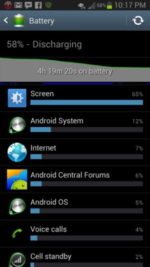

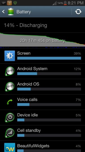

Ok, you are showing 3G on your phone and your signal is good in all the screenshots but one. How many hours a day are you getting out of a charge?
I would say I get about 10 hours from a charge. BTW, I want to thank everyone for the help. I have learned some things.
This is mine right now, but I have been online for at least 3 if the hours I have been in battery.
The 2nd shot with 20 hours, was a kind of light day.
Sent from my SAMSUNG-SGH-I747
