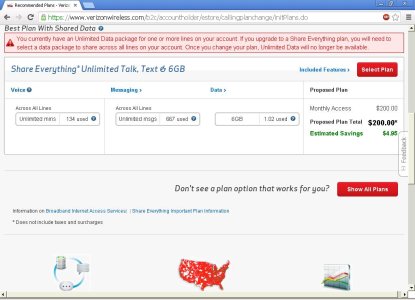

If I go to "change minutes, text or data" it says my plan is no longer available but I don't see anything explicitly mentioning my unlimited data. I also show it list me a bunch of plans but don't see a "show all plans" anywhere.
Here is what I see when I go to change minutes, text or data - show all plans is a red button on the bottom right after it asks don't see a plan that works for you? Then when I click the show all plans button I get the next screen shot showing me my data plans.

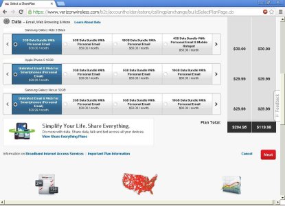

The webpage I get looks totally different than yours. I also notice the URL you end up at is different than the one I end up at.

Re: [Instruction]How to Keep Unlimited Data on Verizon
just keep an eye on it by looking at your useage then. I am sure all will be fine since you activated the phone first on a tiered data line.
