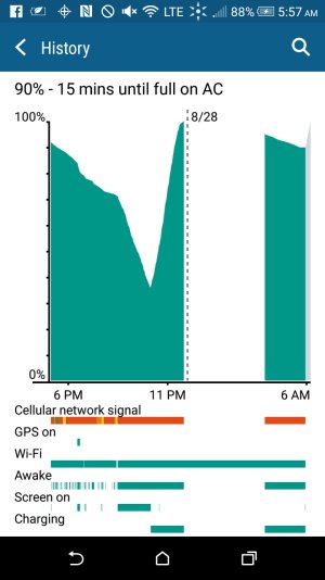

I posted this in another thread. This is what my battery history looks like overnight. This happens during the day too. It's as if it thinks the battery is completely dead for hours. This happens with the charger that it came with, and every other charger I've tried with it. I've also used different outlets. I have not tried a quick charge charger, they're kind of expensive.
Re: Is anyone's battery after 5.1 (Verizon) update...
Okay the last two nights my phone my phone hasn't charged and actually lost battery. I noticed in the screen shot above and on my phone that it is staying awake while on the charger. Wonder if it has anything thing to do with a rogue Verizon app.
