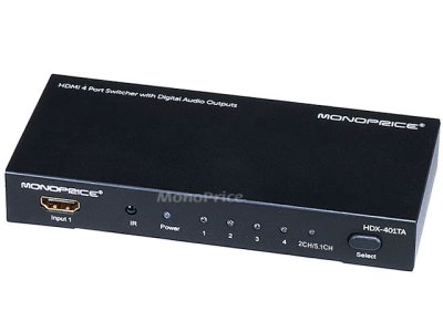

Just received my Chromecast today and it works on my Monoprice HDX-401TA "4X1 HDMI? Switcher w/ Toslink & Digital Coaxial Port (Rev.2) w/ 3D support". I have Chromecast on port 1, Roku3 on port 2, Blueray disc player on port 3, and Comcast DVR on port 4; audio is split via optical coax to my receiver. Everything (except the Chromecast, obviously) including the switch is controlled via Harmony remote.

I looked a little closer and checked my invoice and the part # is 500112 (PID 5557). So maybe mine is older. If you look at the picture, you will see its almost identical except for the labels. Maybe I need to swap

Solidmate is a trademark of Monoprice. Was yours in the clearance section maybe? Contact them, those are real employees you are talking to through their chat.
Re: compatible with an HDMI switch?
I purchased on 12/28/11 for $43.21 which is the current price but i guess it it possible. Without the HDMI out plugged into my TV, the Chromecast connects and plays fine (audio only) and the LED is white but as soon as I plug in the HMDI cable, it goes red and shuts off and my phone wont find it. Tried this switch on my Sharp and LG TV's with the same results. Tried another switch I found that I never used (HDX(C)-501E and it works just fine on both TV's but i need the 3.5mm audio and optical out that the other switch has. I will contact them and i guess buy another switch. Thanks
EDIT: Talked with Monoprice and the one I purchased was actually prior to the 5557 (pid #500112) and was before they revised it. So it looks like i will buy another

Interesting. I just received one of these switches from Monoprice. Chromecast and PS3 do NOT work with it. I get no sound or video. My TiVo does work. It seems strange that it would work with TiVo and not the others. I tried lots of different combinations and even tried it on another TV. I guess my box is defective. Looks like I'll be calling Monoprice today. :(

So I have now tried 3 of these Monoprice HDMI switchers.
HDMI Cable, Home Theater Accessories, HDMI Products, Cables, Adapters, Video/Audio Switch, Networking, USB, Firewire, Printer Toner, and more!
None worked with my older Mitsubishi HDTV with only DVI and a 1 year old APEX HDTV. I finally decided to try it on a neighbors Samsung HDTV and lo and behold the switcher works. To clarify, TiVo DVR was the only thing that worked with the switcher on my Mitsubishi and APEX HDTVs. My cable boxes, PS3, and Chromecast did not work. However, they all work flawlessly on a fairly new Samsung HDTV.
Any idea what would cause this and if there is anyway to fix this?
