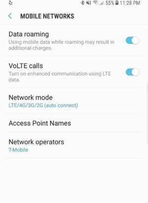

I have the option for VoLTE on my unlocked S8+ using TMobile. It's under mobile networks.

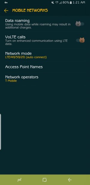

I have a T-Mobile sim PLUS a AT&T sim and I tried each one in my unlocked S8+. Below are the screenshots. With T-Mobile, have the Voice over LTE option under Connections/Mobile Networks.

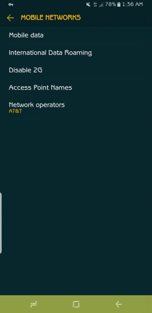

Using my AT&T sim, I don't have any option whatsoever to use Voice over LTE and I do not have an Advanced calling section anywhere on my phone. I hate AT&T though because you see my reception at home is almost non existent and I do not have LTE at home so that is why I have always used T-Mobile over the last 5-6 years.

For ATT the setting is called "Enhanced LTE Services".
Path is: Settings > Connections > Mobile Networks > Enhanced LTE Services
If you don't have this - odds are its locked out for your unlocked device.
I had this same situation for my Google pixel.
There's no way for ATT reps to enable this for an unlocked device. If I had to guess it's blocking at IMEI.

At&t blocks VoLTE on all phones that arent At&t phones. You had the Mate 9 also right? It was the same for the Mate 9. T-mobile allows VoLTE for unlocked phones which is why they are a great option for T-Mobile but not so much At&t.
No sim swap, or resets will get you VoLTE (HD Voice) on At&t and there is nothing the reps can do to enable it. At&t would have to open this option up to its customers and they wont because it forces you to buy from them.
The only reason to have an unlocked phone on At&t is to avoid bloat or if At&t doesnt offer that device (like the Mate 9). If you want these features you either have to swap to an At&t phone or flash the At&t firmware on the unlocked one.
