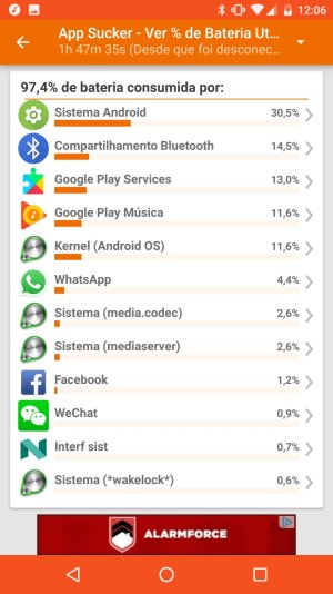

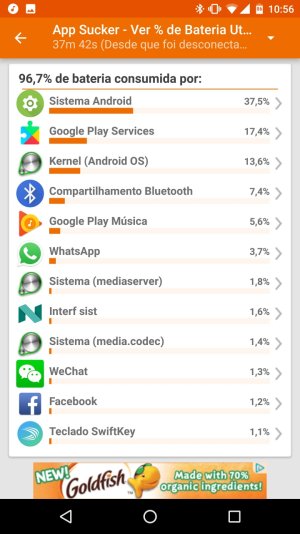

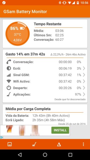

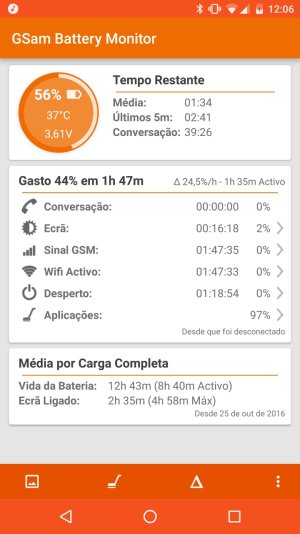

I'm frustrated about how fast my battery drains, but I'm not sure whether my experience is truly abnormal or I am just bemoaning the inevitable, so I thought I'd consult expert opinion. I'm attaching four screenshots from the GSam battery monitor. As you can see, the apps manage to drain a huge amount of battery without using much screen time ("ecrã"). What do you think? And what, if anything, can I do?

Yes, there's certainly something unusual going on to go from 100% to 86% in just 37 minutes. There's nothing obvious in the app list itself since those items are frequently at the top of the list but the OS shouldn't be causing such a precipitous drop.

If you look at the 'Sinal GSM' data does that look okay? Just want to be sure the phone isn't struggling to make a cellular connection. (You can also look at Settings -> Battery -> History details (tap the graph to get this view) to see what the cellular network signal is like).

Edit: were you streaming music using Google Play Music, over Bluetooth, that whole time? Those two items seem out of place in the list.

I've just opened the "Sinal GSM" and it says that the signal strength is strong and it has been 1 second since it was disconnected. This statistic doesn't seem to update. I've force quit GSam and opened it again. Same problem. Is it an issue that I'm charging at present?
I use the combination of Google Play Music (I'm loath to perform a factory reset yet because I have a vast amount of music stored) and Bluetooth pretty continuously, my soundtrack. But should that be causing this level of drainage?
