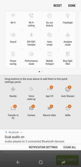

Is the a shortcut to turn data off?
I'm on Verizon but you might be able to put a shortcut on a home screen using Quick Shortcut Maker. I've been using this app for many years on all my Android devices for shortcuts that Verizon doesn't think us users need. It's free and works fantastic. Link to it in the play store: https://play.google.com/store/apps/details?id=com.sika524.android.quickshortcut
Once you install the app, open it and do a search for "mobile data". What I found on my Verizon version is this in the screenshot, that will bring up the screen with a toggle to turn it on or off. I just tried it after seeing this thread. Once you find the correct toggle, you can test it before creating the shortcut on your home screen. At that point it would just be a tap on the shortcut which would open the screen with the switch and then tap on the switch to toggle on or off.

I found the data setting, but when I created the icon I can't find it. Does the app create and icon on the phone? Ps. The video was removed 😫
Yes, the app puts a shortcut on your home screen. Once you test it and it works like you want by tapping on "try", go back and tap create at the bottom which then puts a shortcut on a home screen.

Forgot to mention, you can also change the name of the shortcut as well as the icon for it, prior to creating the shortcut. It's one of my all time favorite apps.
It looks as off the app doesn't support Orio that's why the shortcut isn't working. 😪. I came across another app that works the same. I appreciate all the tips.

Check out "Shortcut Creator"
https://play.google.com/store/apps/details?id=com.alextern.shortcuthelper. I also tried tiles and this is great, you can access via the quick settings.
Check out "Tiles"
https://play.google.com/store/apps/details?id=com.rascarlo.quick.settings.tiles

I tried to use the quick shortcut app from Playstore, but it did not work on my Verizon Samsung Note8 today.
