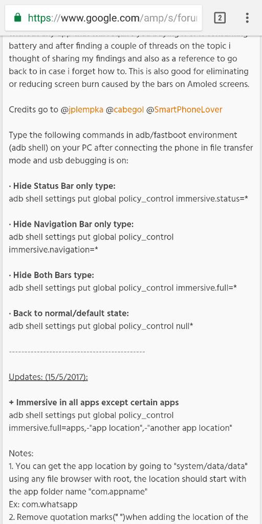

Howd you do this? Adb?
Yep. I used this guide.
