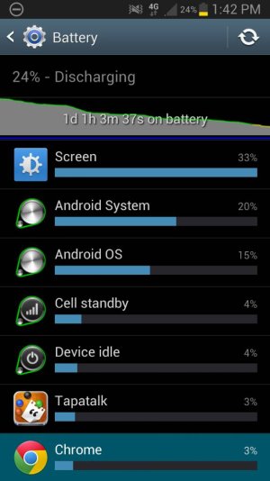

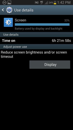

When I'm on lunch today I will list everything I have checked along with my battery life today. I can tell you right now I'm at 35percent left with 22hrs of on time. 5hrs 41mins of on screen time. Also I have had no signal for 3 percent of the time. In my book almost 6 hrs of screen time with 35 percent battery life is great.

And this was watching 2 movies with it. Taken 2 and Ted

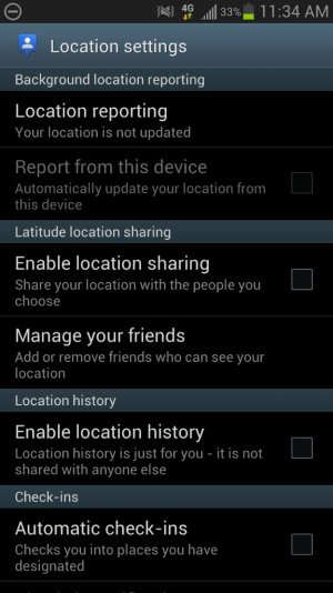

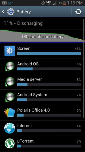

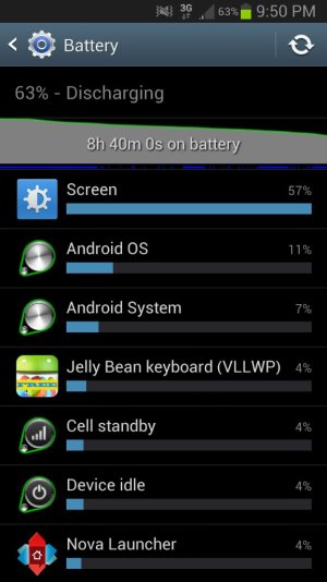

Ok here is what I have for settings. Hopefully this helps. I've also attached my current stats.
Wifi ON
Wifi kept always ON
MORE SETTINGS sprint optimization ON
NFC/SBEAM OFF
Blocking mode ON
LED OFF
Screen mode Standard
Brightness moved the dot to under the G
Auto brightness OFF
Screen out 30 seconds
Smart rotate ON
Smart stay ON
Touch key light 1.5 seconds
Power saving OFF
Location services checked on
GPS OFF
Location and Google Checked
Cloud samsung sync OFF
Backup OFF
Facebook sync OFF
Google sync All on
MAPS location reporting OFF
Motion OFF
SPEN Battery Saving checked
SPEN KEEPER unchecked
Air view OFF.
Sent from my SPH-L900 using Tapatalk 2
