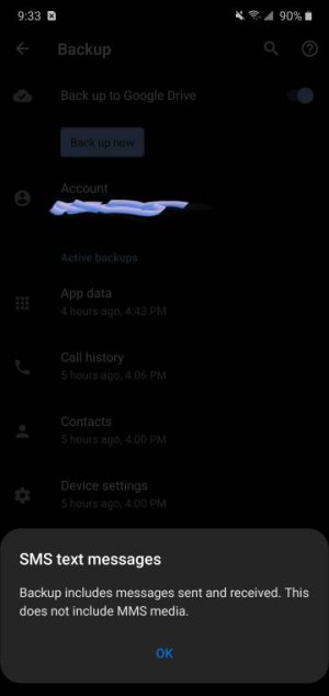

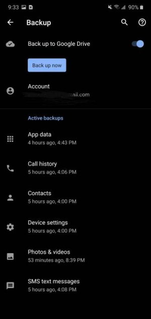

Like what's your thinking about the Samsung message causing this ? I have both on my phone and no issues. So I like you to look at something , go into settings >accounts>back up look at Google back up is everything sync with messages , look at data last sync compared to others on the list sync.

Mine is
Gotcha, thanks. I was looking under the account sync settings and not the back up settings. My backup is slightly different. But I mainly use Samsung account as a back up.
