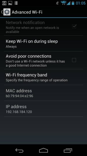

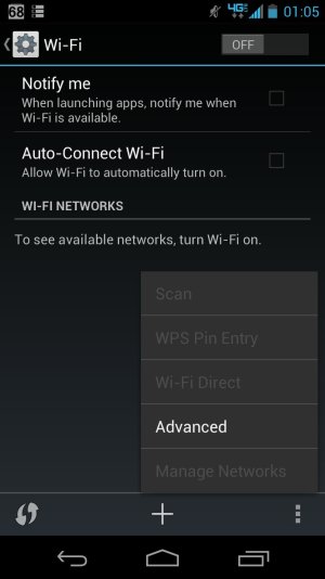

Curious. Do you have the option to "Avoid Poor Connections" checked in the Advanced sub-menu within the WiFi settings menu? See my screen shots. I have turned my option off (unchecked the box) and that helped some of the problems I was having with the WiFi connection at work.
Sent from my Droid Razr MAXX HD.

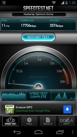

Just found this thread after finding the same issue with my razr hd. You can see that the download speeds are fine, and everything works as it should but the wifi signal definitely shows that it's weak (you can see it in the screenshot). I also tried unchecking the "avoid poor connections" option, but it didn't work. This is a rooted razr hd running jelly bean, btw.
